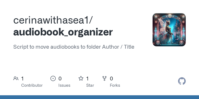

this is not exactly what you are looking for but i made this to use metadata to move my audiobooks and create folders if any books are added ti the folder it watches
maybe you can use ai to convert it for renaming
