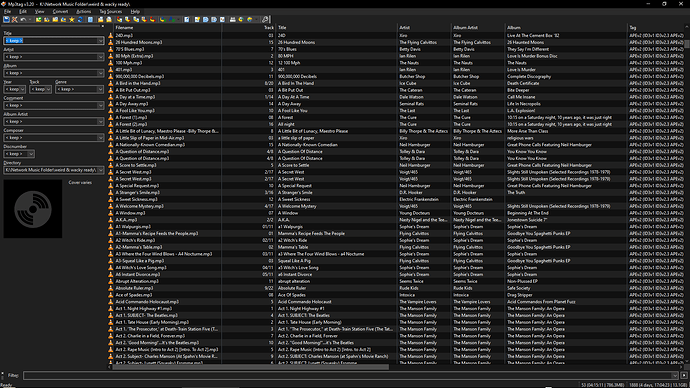

So as you can see with a little studying of this photo, the only real problem here in these remaining files, as I see it, is that the track numbers are not right. This is why I am trying to do this. I am not sure I ever made that clear. The file names are easy to fix. The goal for me, is to get track numbers for albums such as the 3 or four seen here. Bulk rename could work on a per folder basis, but the bulk rename utility does not have the option to set metadata only renames files.

I cannot see where the data in TRACK should not be right.
I can see that some files follow a different pattern than others e.g. that they only show the artist's name.
So I would rename the files with Convert>Tag-Filename
Format string: $num(%track%,2) _ %artist% _ %title%

Once again, my edits are leaving my words behind in the flow here...I had already done the track numbers. This block of files is retagged. The only reason I am still able to view these 1888 files here in this folder, is because I have not yet gotten to the stage where I move them out of the folder and add artworks and place them in the other computer, and on phones.
We can see on the screenshots that the filenames are still a mess for some of these as well.
