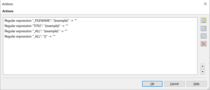

And another
[#0]
T=4
F=_FILENAME
1=(example)
2=
3=0
[#1]
T=4
F=TITLE
1=(example)
2=
3=0
[#2]
T=4
F=_ALL
1=(example)
2=
3=0
[#3]
T=4
F=_ALL
1=()
2=
3=0
This example with "example" features some rather questionable ideas:
If you replace the text "(example)" with nothing, it is a text constant, so it is not really a pattern that has to be defined in a regular expression. So an action of the type "Replace with regular expression" is probably not the optimum.
This is combined with rather sloppy code because the brackets, which serve a special purpose in regular expressions, are not escaped.
Only this circumstance makes it necessary to have a 4th action which again replaces a text constant in a regular expression ... discussion see above.
I would see this example as a bad example.
