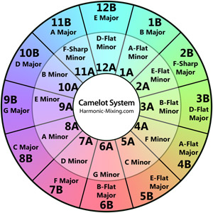

One Issue I'm having with the action script - the Camelot scale doesn't have a number for G# Minor, A# Minor, or C# Minor, like it does on the Circle of Fifths, so when I use the action script on say, this song it doesn't change.
The correct way to label these on a Camelot wheel is:
A-sharp Minor = B-flat Minor (3A)
G-sharp Minor = A-flat Minor (1A)
C-sharp Minor = D-flat Minor (12A)
I had a look at the Action Script and it looks like I was able to fix it by adding these to it.

# INITIAL KEY TO CAMELOT NOTATION # DO NOT CHANGE VALUES OR DELETE BETWEEN THESE LINES IF NOT NEEDED #
    replace "A♭ Minor" "1A"
    replace "E♭ Minor" "2A"
    replace "B♭ Minor" "3A"
    replace "F Minor" "4A"
    replace "C Minor" "5A"
    replace "G Minor" "6A"
    replace "D Minor" "7A"
    replace "A Minor" "8A"
    replace "E Minor" "9A"
    replace "B Minor" "10A"
    replace "F# Minor" "11A"
    replace "D♭ Minor" "12A"
    replace "B Major" "1B"
    replace "F# Major" "2B"
    replace "D♭ Major" "3B"
    replace "A♭ Major" "4B"
    replace "E♭ Major" "5B"
    replace "B♭ Major" "6B"
    replace "F Major" "7B"
    replace "C Major" "8B"
    replace "G Major" "9B"
    replace "D Major" "10B"
    replace "A Major" "11B"
    replace "E Major" "12B"
### MISSING CAMELOT SCALES ###
    replace "G# Minor" "1A"
    replace "A# Minor" "3A"
    replace "C# Minor" "12A"
What I need is all the remaining Camelot notations to match the missing scales. So.....
Thanks 'chriswike' for pointing that out. I had already noticed that but not gotten round to modifying the action which will no longer be needed once I have the script finished. I have everything working.
I just need to find out:
How you came about these values? The other values I have noticed missing such as 'D# Minor'? Are there other values that I should be aware of that are missing?

Major
1B      B/H
2B      F#
3B      D♭/C#
4B      A♭/G#
5B      E♭/D#
6B      B♭/A#
7B      F
8B      C
9B      G
10B     D
11B     A
12B     E
Minor
1A      a♭/g#
2A      e♭/d#
3A      b♭/a#
4A      f
5A      c
6A      g
7A      d
8A      a
9A      e
10A     b/h
11A     f#
12A     d♭/c#
Basically, notes that sound the same are written differently because they have a different function beyond just sound.
http://en.wikipedia.org/wiki/Enharmonic_change
That should explain some
Please ask any questions you have about
Thanks DetlevD, I have studied music production, only for a 13 weeks on a 1 week basis. Maybe I was asleep during the Music Theory class :] only joking. I got it now its basically the fact that there not listed on the Mixedinkey wheel which threw me slightly.
An example of a beatport lists a track as been in the key
D♯ Minor (Harmonic Scale) = E♭ Minor (Harmonic Scale) = 2A (Camelot Notation)
Its the same root key. Different function. Different name. Its all coming back to me now.
