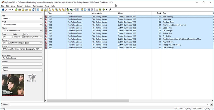

Album name is Demons and Wizards 2003 by Jethro Tull. I want to keep album name but have the information to be in between brackets like [remastered 2003]..
Since i have lots of albums in different can anyone help to offer a script ?
Thanks in advanced,

Here you will find the attached before and after images..thank you very much
Try an action of the type "Format value" for ALBUM
Format string: $regexp(%album%,(.*) (\d+),$1 '['Release $2']')
Thank you very much. Worked like a charm
