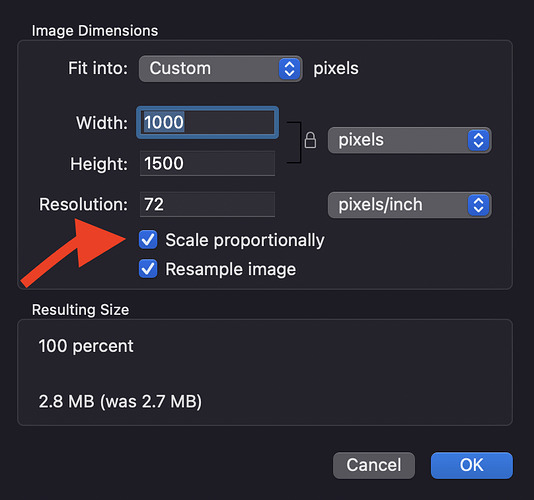

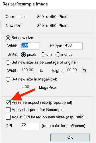

Much appreciated. I am only a home enthusiast, I don't know if there is a proper term for it, but I wanted to share the settings from various image programs that I had as a frame of reference for the function I was trying to point you toward.
These are from Preview (Mac) and Paint3D, IrfanView (Windows)

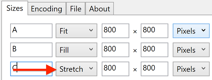

and one more example from ImageResizer (windows) which uses the terms Fit, Fill and Stretch. I believe your program currently would be considered Fit since it scales to the nearest size within the maximum.
