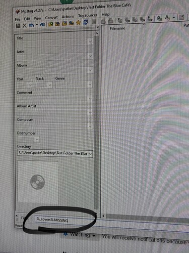

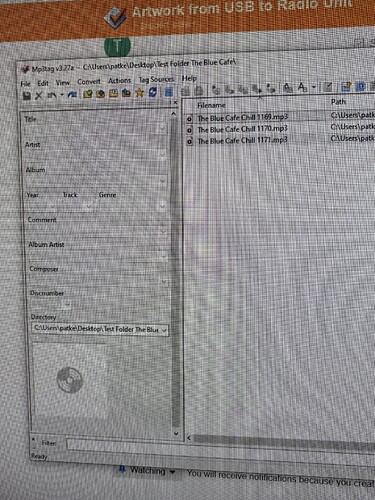

Thank you very much for info. So I assume after I drag my three tracks in I enter the filter into the filter line at bottom of page like in photo's. I may be doing this incorrectly. As you can see when I enter the filter the three tracks disapear.
I would say that this is a good sign in respect to verifying that the pictures are actually embedded.
It means to me: if your player could display pictures then it would simply have to look at the files as they bring the pictures along.
