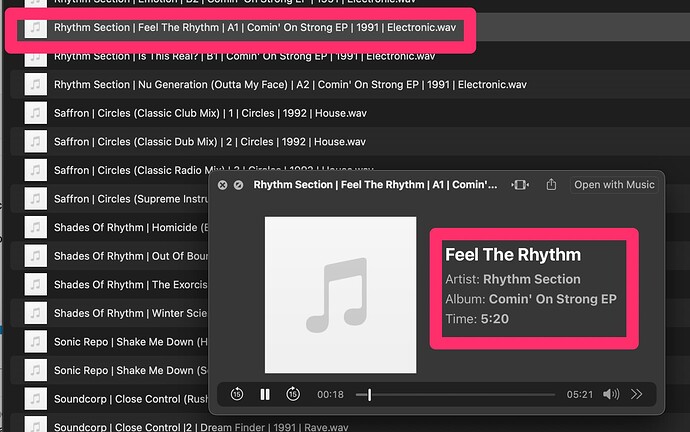

Hmmmm, a bigger rethink may be necessary. It's not just the artwork that is the issue. All of the ID3 tags that I am saving seem fine in the WAV files when I do a Quick Look in Finder (SPACE to play).

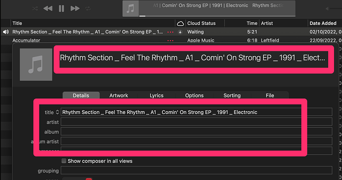

but when I drag the WAV into Music app, it does not show/use the ID3 tag data - it shows the filename:

The original wav format doesn’t really support any tags. So in the Music app you will only get the basic details. If the main player is going to be the Apple Music player, consider ALAC as your main lossless format that has full metadata tag support.

However, the thing I don't get is why it does show the ID3 data just fine when using Quick Look (first image), but ignores it all in the Music app. Very odd.

Likely a difference between what the OS does for Quick Look versus the Music app.

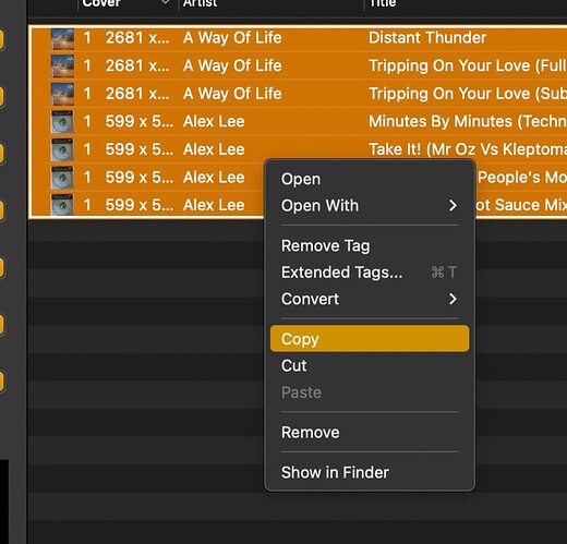

No export is required. Highlight all of the original songs in the order you expect, right click and select “Copy Tags” in that menu. Then highlight the new songs that are in the same order, right click, and select Paste Tags.
Ah, see if I had seen a 'Copy Tags' option that would have been easy/obvious, but ...
It just says Copy, so my assumption was that this was copying files. Same with the Paste option, it does not say 'Paste Tags'
However, I note that having done that, the dialog that VERY briefly appears indicates it is pasting tags.
So now I understand this is the process, but the UI was not clear that this is what it would do.
Also ... it doesn't copy/paste artwork :frowning:
