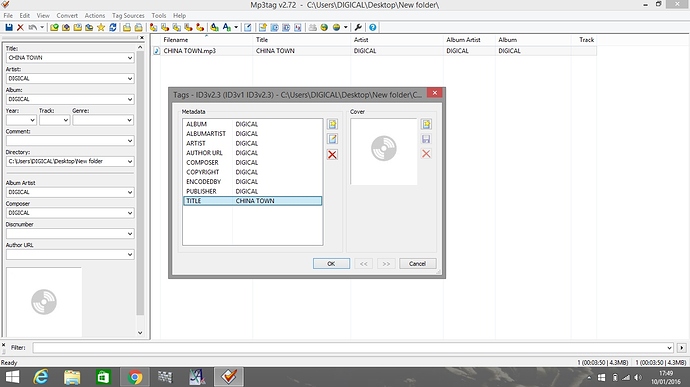

Hi, Thanks for your reply but unfortunately I am no closer to solving this problem.
I have attached a screen shot of the extended tags i want to change.
As you can see, "Author URL" is one of them. All the other fields will change in the mp3 files properties except for the "Author URL"
I am able to change "Author URL" manually in the properties but i have multiple files to work on so i would like to do them all at once. I have checked out the other options you suggested and they are all correct.
If you are able to write a step by step guide that would be most helpful.
Thanks again for your time!

Short answer: use WWWARTIST in the Extended Tags dialogue, not AUTHOR URL, and %wwwartist% when creating an entry in the tag panel or a column header.
Explanation:
This situation arises when different applications call an ID3 frame by different internal names.
The ID3 frame names are short and cryptic and that is why applications use an internal name that is sensible and readable instead of the name specified in the ID3 standard.
ID3v2.3 informal standard: http://id3.org/d3v2.3.0
In this case, the tag frame (or field; the terms are interchangeable) is named "AuthorURL" in Windows Explorer and "WWWArtist" in Mp3tag, but both applications are reading and writing the ID3 WOAR frame.
The bottom line is this:
If you want to use Mp3tag to read or write the "Author URL" detail in WE, you must call it "WWWArtist" in Mp3tag.
You can demonstrate this yourself:
  • -choose a test file that does not have the "Author URL" detail
  • -in Windows Explorer, edit the "Author URL" detail by writing any text string
  • -load the file into Mp3tag
  • -in the Extended Tags dialogue, observe that the string appears beside WWWARTIST
This and other tag field mappings are shown here: https://docs.mp3tag.de/mapping
After you get that working, you might want to investigate user-defined mappings: https://docs.mp3tag.de/customization/options/tags/mapping
For example:
By creating the following mapping, the item in the Extended Tags dialogue will be "AUTHOR_URL" which more closely resembles "Author URL" as seen in WE.
Go to Options > Tags > Mapping
Tag: ID3v2
Source: WWWArtist
Target: Author_URL
I recommend avoiding spaces in the target name but you can use some other words.
When the mapping is used, you use the target name as the placeholder in format strings (eg. %author_url%)
