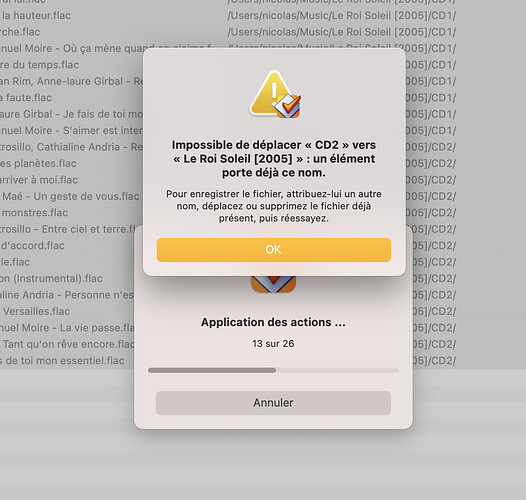

When I have an action to rename a directory in an action group, MP3tag report an error:
"Impossible to move to x from x..."
I have to create a separate action to rename the folder :-/

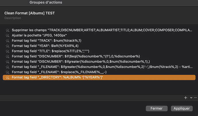

Here are the task with all actions:
I think there is an issue with the directory management:
On Mac, merging is more specific than Windows and I think you have to use this specific merging option because if you attempt to move files with an action in the same directory, we have the error: the element already exist and cannot be replaced

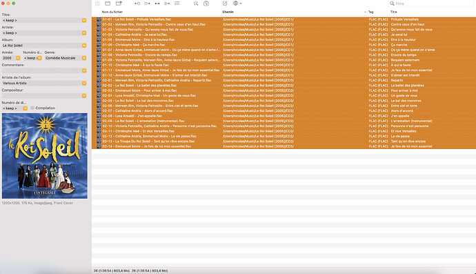

For example:
An album with two discs and this structure:
folder/cd1
folder/cd2

I used a lot Mp3tag on Windows and when I changed the _DIRECTORY field, all the files were merged in the same folder.
In MacOS, merge does not work...
Here are graphical details:
My original album with two discs structure
Format tag directory field

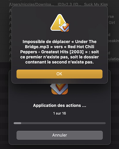

Error on validate
At the end, the result on Mac
