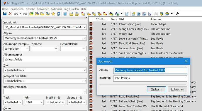

Call of TAG SOURCES for VARIOUS ARTISTS sampler
The call of TAG SOURCES for samplers with different artists differs for MUSICBRAINZ and DISCOGS.
When MUSICBRAINZ is called, the misleading artist of the first track is transferred, not the ALBUMARTIST.
Is this a bug or a feature?
Could you please show us a real example to reproduce this behaviour?

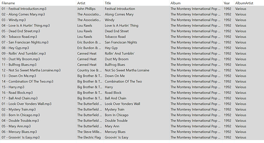

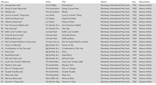

In both cases, I get Various Artists or Various in ALBUMARTIST:
MB:
DG:
Can you please describe in more details, what you would expect to see in ALBUMARTIST?

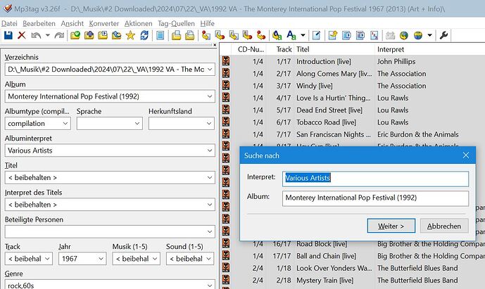

Because the search with Various Artist (= albumartist) instead of John Phillips (artist of first song on disc1) brings wrong results.

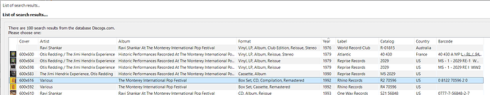

The search in discogs immediately brings up the right entries.
In Discogs the Artistname of album-compilations is "Various" instead of "Various Artists".
So you have to search for "Various".
If you have filled your albumartist-fiels with "Various Artists" and don't want to change the search manually each time you can change the script to
[SearchBy]=Artist||$if2($replace(%albumartist%,Various Artists,Various),%artist%)||&artist=%s||Album||%album%||&release_title=%s

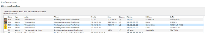

However, when searching in MUSICBRAINZ, MP3Tag always suggests the artist of the first track, even though ALBUMARTIST contains the correct value 'Various Artists'.
Everything can be corrected manually, but the values for the correct programme logic are available.
The Monterey album is just one example of this behaviour.
