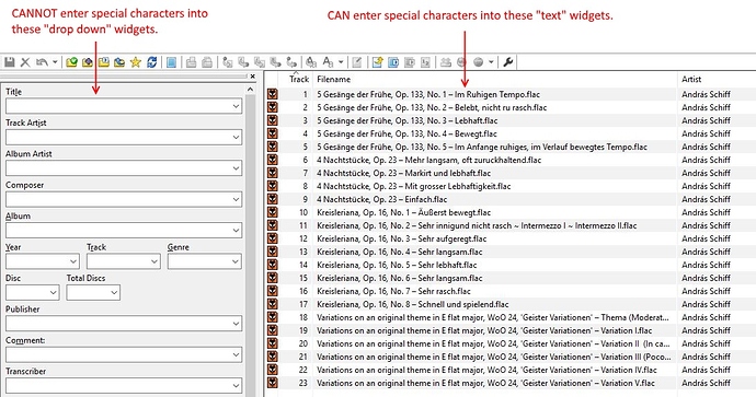

I can't believe that I never ran into this problem before, because I've been using this great piece of software for the last X years. Virtually all of my music is classical. And in this genre you run into characters with diacritical marks all the time, like: É, à, é, ô and ü.
I usually enter these characters when I rip my CD's by using the Windows keystroke Alt + digits, where digits are the 4-digits typed on the numeric keypad that correspond to the character I wish to enter. But recently I started adding custom metadata fields to the Tag Panel. The problem I found is that you can't enter the special characters into the drop-down boxes; you can paste them, but not type them.

I just tried it with Alt-0201 in the tag panel (on the left in the screenshot) which gives É and it worked.
I saved the modification and it stayed.

I cannot believe how stupid I am sometimes. I won't try to wiggle out of it. I don't just have egg on my face, I have the whole chicken's butt on it. I had the NumLock key OFF.
Hold on a minute. I just tried a little test. With the NumLock key ON you can type special characters
in any field. With the NumLock key OFF you cannot type special characters into the Tag Panel, but you can type them into the table text fields. That's the behavior I was seeing, and this latter scenario led me to believe that the NumLock key was ON. Windows, love it or leave it.

Hello again. Ok, after reading all of your posts I think that I've figured out the behavior. First some background:
To get a keystroke combination I used the Windows Character Map application.
I created and printed out a little table of all the characters that I use.
Virtually all of the characters are of the form "Alt + 02xx", A few of the 'A' category begin with "Alt + 01xx".
So, with the NumLock key OFF, I found:
Pressing the number 2 or 8 displays the values '< blank >' and '< keep >' because these two keys also function as a down arrow and up arrow, respectively (on my keyboard).
Pressing "Alt + 2" or "Alt + 8" opens the drop-down list (which may be the default behavior for Alt + Up/Down arrows and this widget).
The same thing happens if you press any one, or more, of the non-arrow keys (0,1,3,5,7,9) before pressing the number 2 or 8.
For example, all these keystrokes open the drop-down list: "Alt + 01352", "Alt + 135792", "Alt + 555558", and so on.
The moral of the story is, "Don't be a NumNut like me, turn on the NumLock key.
