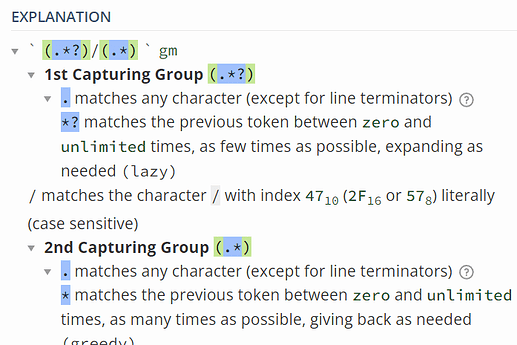

You can copy & paste such expressions to regular expression test websites like regex101.com
They give you an explanation for (.*?)/(.*) like this:
The 1st Capturing Group is represented by $1
The 2nd Capturing Group is represented by $2
In the above example $1 - $2, there is a space, a hyphen and a space between the ouptut of $1 and $2
(dividing Capitol Hi-Q L-028 from Metro/Light Activity/Toy/Comedy)
The regular expression will be combined with a $replace command, where all space hyphen will be replaced with as slash.
