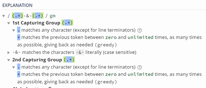

Specialized 3rd party tools like regex101 show and explain such (non working) regular expressions - the "searching" part to be exact:
You have only 2 capturing groups $1 and $2 in your regular expression, therefore you can't replace the content of the not existing $3.
