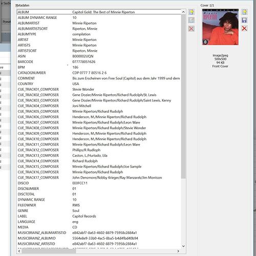

Every record of an album carries all the composers of all songs.
How can I transfer the embedded CUE_TRACK_COMPOSER to the corresponding COMPOSER field?
I have a few albums with this issue.
At the moment I only see the not so comfortable solution to create an action group with actions for every possible tracknumber.

Thank you for your idea. ![]()
It would surely help.
I will still try to find a better solution. ![]()
