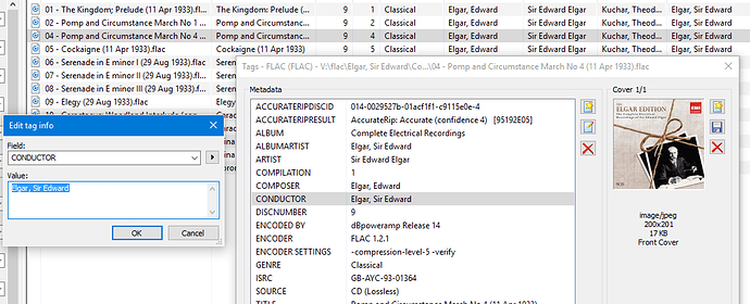

I'm having an issue with the conductor field (I have predominately classical music) in FLAC files. The 'conductor' field refuses to change when I update it. I have tried this via the standard GUI and via the 'Extended Tags' dialogue. When I change the tag it just goes back to what it was.
In the example screen shot attached, the conductor has come from a previous CD I was working with and has no relation to this recording.

I have added the 'Conductor' field to the tag panel and this looks correct (see screenshot) but the conductor columns still shows the wrong info. If I edit it in the column, as soon as I press enter, it reverts to the bad data.

I'm not sure how to do that but the screen shot below shows the extended tag dialogue and that the field being used is 'CONDUCTOR'
The correct value is shown every where apart from the main GUI.
