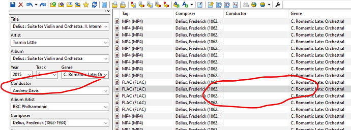

Re Conductor field info disappearing:
In the attached screenshot I have a Conductor column - blank, but in the panel on the left the Conductor field is showing 'Andrew Davis'
If I type in the field in the right hand panel and then move off the field, the left hand panel is populated correctly, but the field in the righthand column reverts to blank.
I was hoping to be able to see a populated conductor field on the right hand panel for all works so I could apply some actions to populate it.

What is the conductor-field-definition in the tagpanel and what is it in the column?
Hi Poster
Here's the column definition - how do I get to show the same thing for the tag panel?
The odd thing is that when I type in the Conductor Column it does update the Conductor info in the tag panel, but then goes blank. So it is populating the correct field in the tag panel..?
Thanks for your help

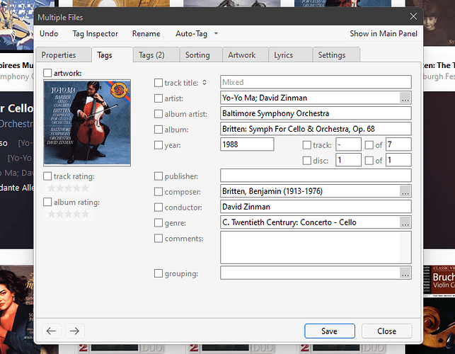

Here's the screenshot from MusicBee:

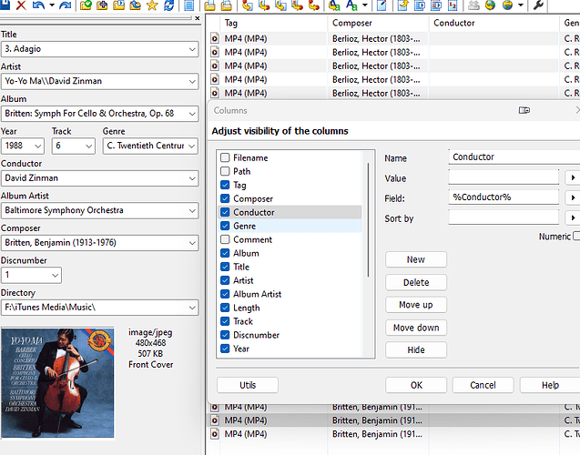

OK - I found how to view the Tag Panel Info...
this what I have..
If you want to see the values of the CONDUCTOR field then you have to fill "Value" with %conductor%.
That, what you enter in the column is then written to the field that you specified - in this case %conductor% again.
Amazing ! Thank you - that worked !
