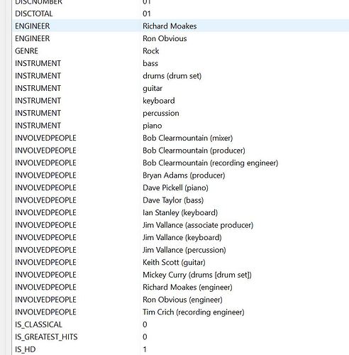

I would like to consolidate various text fields.
For example, I would like to integrate the ENGINEER field into INVOLVEDPEOPLE and then delete it.
Duplicates should be avoided or removed.
I have attached the data for a song as an example.
The two instances of ENGINEER are contained in INVOLVEDPEOPLE and should be removed.
If there is an ENGINEER named ‘Albert Einstein’, it should be added to INVOLVEDPEOPLE.
I have tried using $strstr(x,y) but am not really getting any closer to my goal.
Does anyone know how to achieve this?
You could ...
Convert>Tag-Tag for INVOLVEDPEOPLE
Format string: $meta_sep(involvedpeople,\\)\\$meta_sep(engineer,==)
Format string: $replace($meta_sep(involvedpeople,\\),==,' (Engineer)\\')
and then apply an action of the type "remove duplicate fields" for INVOLVEDPEOPLE but tick the option to remove only those with identical contents
