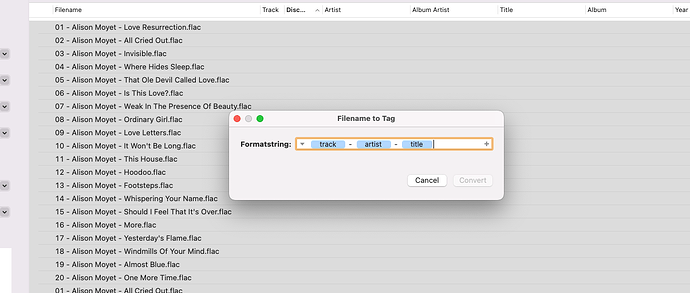

And can you post a screenshot of the filenames and the format string you're using with the converter? Usually when this happens, it's a format string that doesn't match the filename.

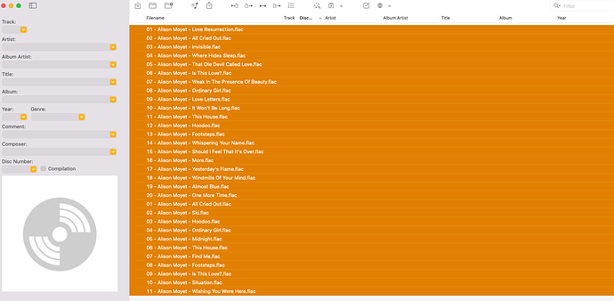

I have taken two screenshots. The first shows the Tracks with the Convert Button greyed out not allowing me to tag the files. The second shows the Tracks with no id3 Tag Information
It looks like the filenames are most likely using an n-dash – (or even an m-dash β€”) instead of a hyphen -.
If so and if you use the correct dash in your format string, it should be working just fine.

It turns out that there were extra spaces within the file names. So instead of - , it was - . Once I removed the extra spaces all worked as it should. Thank you so much for your help!
