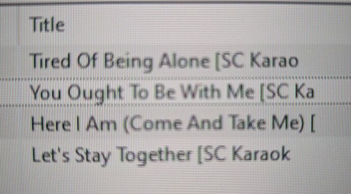

I’ve followed some of the examples I found but still can’t get it to work.
My titles say “Name of Song” [SC Karaoke]
And variations of that, ie, just [ or [SC, ect….
So I have been trying to replace/delete everything from “[“ on.
I mean, I know they are Karaoke , don’t need the reminder, plus it will show up in the listing of the Karaoke software I am using.

What does this screenshot tell?
Have you tried the suggestion?
@ohrenkino's suggestion works fine even for your example with parenthesis/round brackets:
Please show us a screenshot of what you have tried so far as Format string.
Yes, sorry it did work, but I thought you wanted to see a screenshot,
Many thanks
