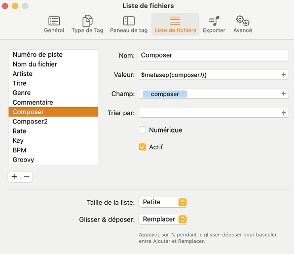

I would like to copy the output of the field "Composer2" into the field "Composer" without erasing the content of the field "Composer" which has currently this value: $metasep(composer,\\)

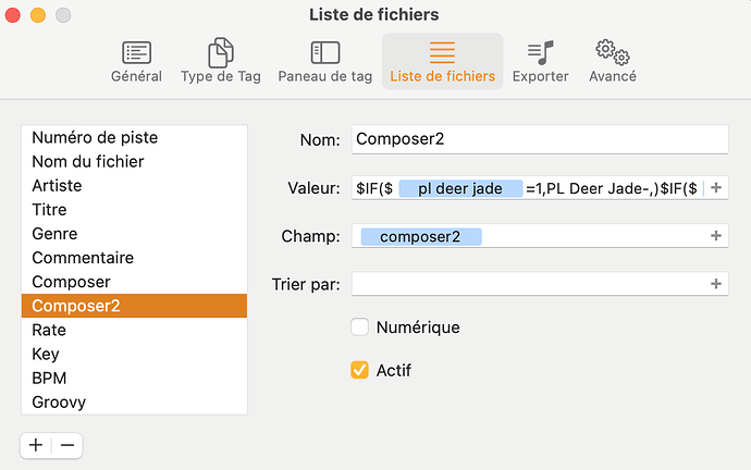

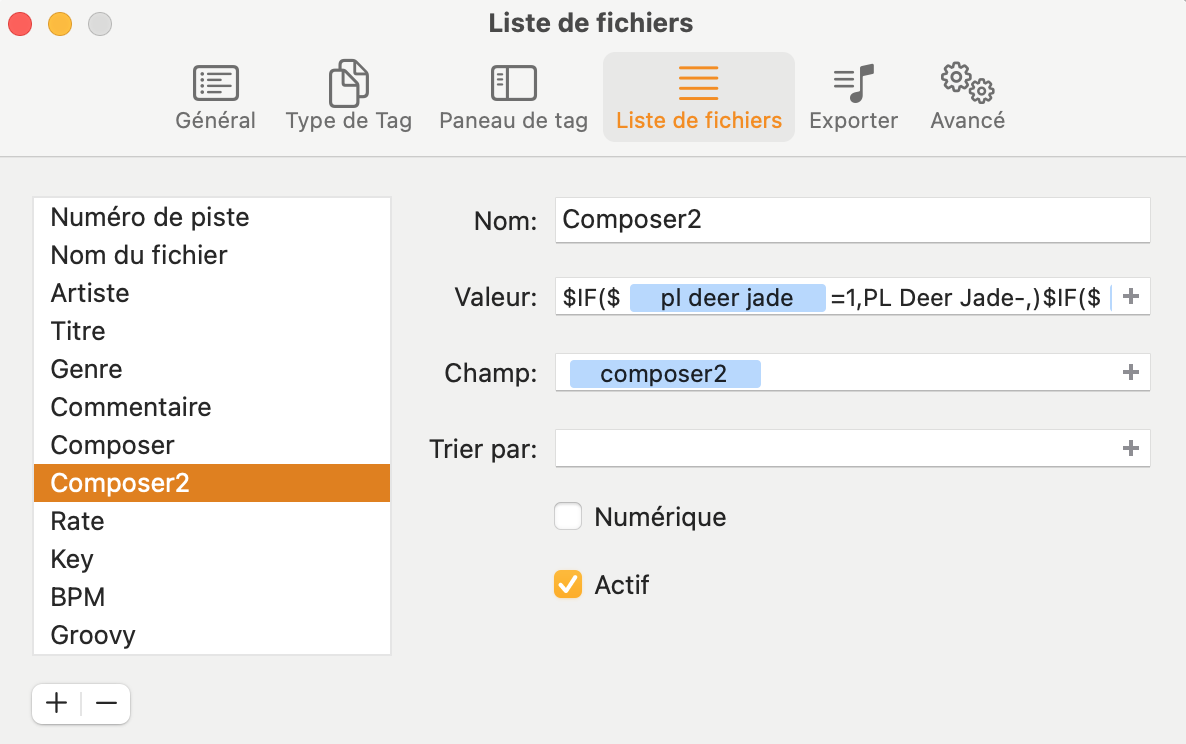

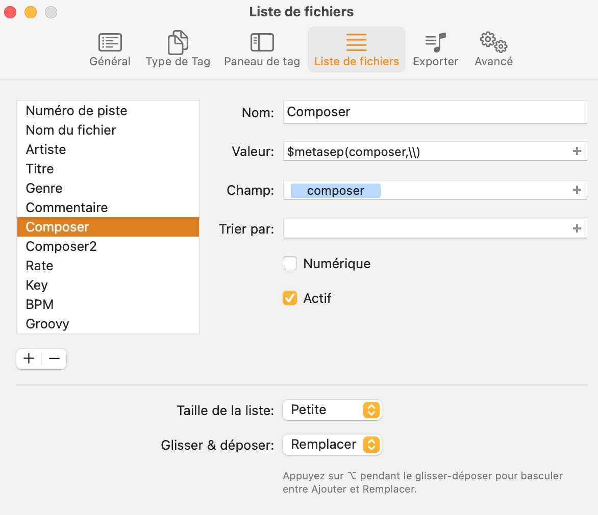

see my configuration in attachment.
Composer2 Value =
$IF($%PL Deer Jade%=1,PL Deer Jade-,)$IF($%PL Bresil%=1,PL Bresil-,)$IF($%PL Laurent Garnier%=1,PL Laurent Garnier-,)$IF($%PL Radio Meuh%=1,PL Radio Meuh-,)$IF($%PL SOLOMUN%=1,PL Solomun-,)$IF($%PL Carl Cox%=1,PL Carl Cox-,)$IF($%PL Luciano%=1,PL Luciano-,)$IF($%PL MOCHAKK%=1,PL Mochakk-,)$IF($%PL Enfants%=1,PL Enfants-,)$IF($%PL French Touch%=1,PL French Touch-,)$IF($%PL GUTS%=1,PL Guts-,)$IF($%PL HOTEL%=1,PL Hotel-,)$IF($%PL MACEO PLEX%=1,PL Maceo Plex-,)$IF($%PL Original/Sampled%=1,PL Original/Sampled-,)$IF($%PL Improbable%=1,PL Improbable-,)
I would like to copy the value of composer2 into Composer field
I also tried an action but I could not found Composer2 for the action. reason why I would like to copy composer2 value to composer field.

I doubt that you can use the display in a field list column to set the value of field automatically.
You would have to use an action of the type "Format tag field" for the target field with the format string that you applied so far for the value of the column.
Unless you really set a (new) value the field either does not exist or does not recognize the displayed value.

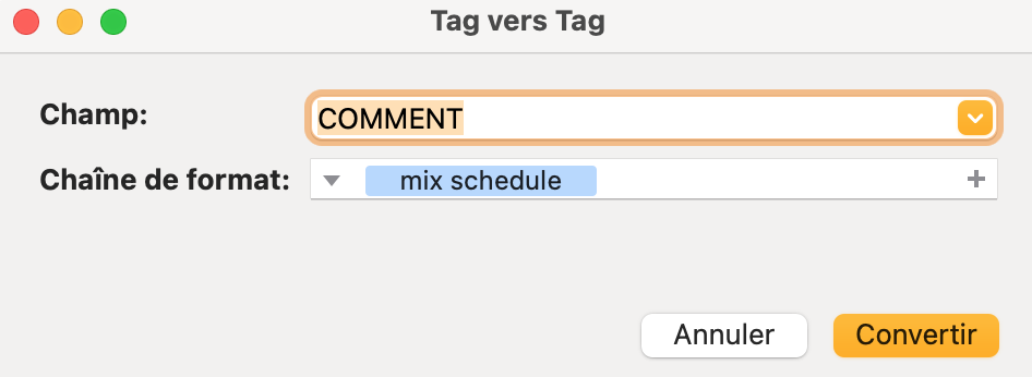

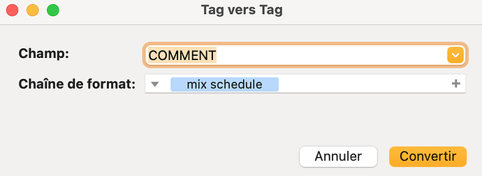

I have done the proposed change and tried to add the "Mix Schedule" info into the comment field through an action but comment field remain blank.
mix schedule value: $IF($eql(%Intro%,1),Intro-,)$IF($eql(%intronobeat%,1),Intronobeat-,)$IF($eql(%Early%,1),Early-,)$IF($eql(%warmup%,1),Warmup-,)$IF($eql(%Peaktime%,1),Peak-,)$IF($eql(%End%,1),End-,)$IF($eql(%Emergency%,1),Emergency-,)
Action for comment ( see attachment)
%mix schedule%
Please check the extended tags dialogue whether mix schedule has a value at all (=exists)?

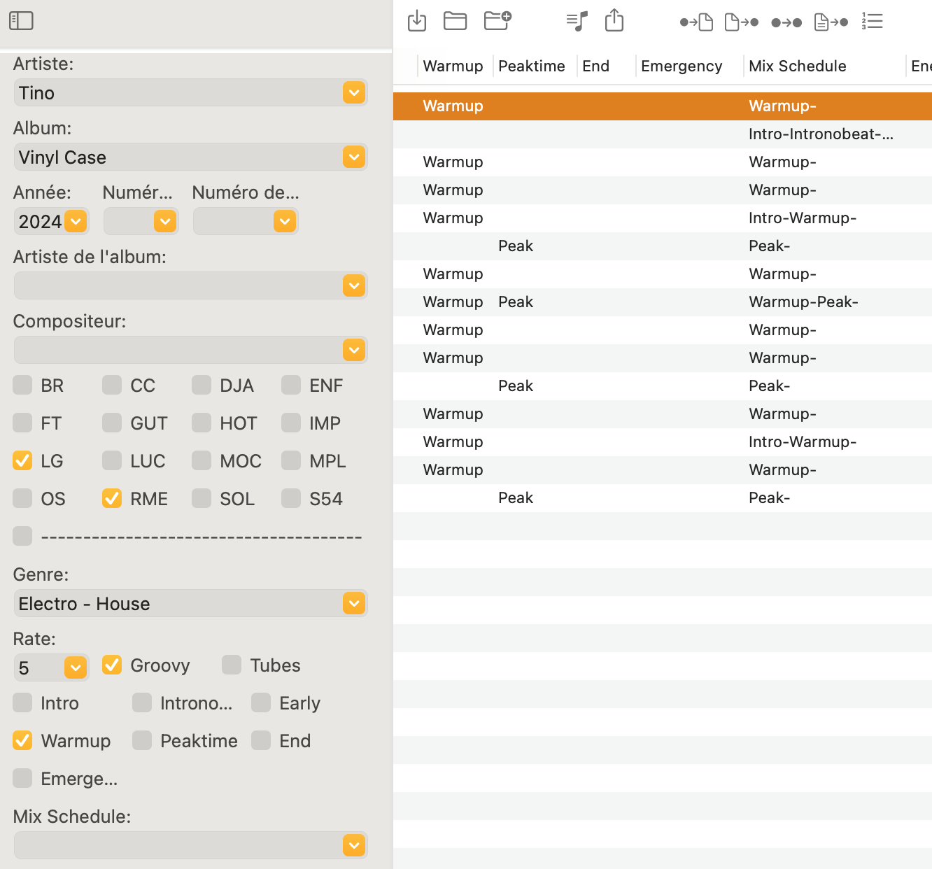

I would create a test file and supply a value for one of your user-defined fields like intronobeat and then check if the expression for mix schedule returns "Intronobeat-" - to make sure that the expression works
on the left tags dialogue menu, "mix schedule" is blank :frowning: but the column "mix schedule" has the correct info ( see print screen)

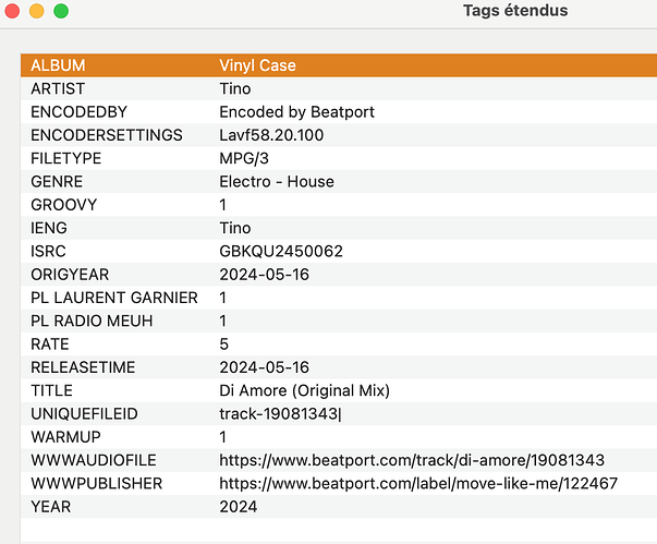

I meant the extended tags dialogue that opens with Command-T.
Please show us the extended tags dialogue and the definition of the item in the tag panel.
Or: the field, that you filled in the file list also has to referenced in the tag panel item definition to show the same data.

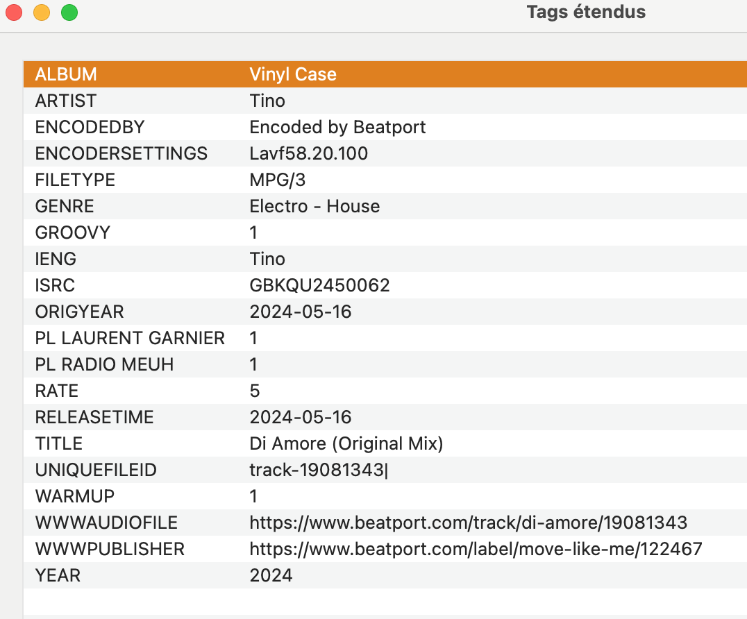

I did command-T and the field "mix schedule" is not in the list...
mix schedule field is recording the output of the checkbox: Intro, Warmup, peaktime,...
Warmup = 1 is displayed below in the extended tags dialogue.
Warmup = 1 because the warmup checkbox is checked on the left tags menu

This prooves to me several things:
  • The column in the file list only displays stored data but the display is not enough to also write it to a field - in this case mix schedule.
  • The field mix schedule has not/never been filled with data.
  • You need an action of the type "Format tag field" to write data to a tag field.
So, after you have filled the various fields like "Warmup", "Early" etc. with the 1, you have to run the action of the type "Format tag field" for "mix schedule" with the format string
And you have to run that action, every time you change something in the individual parts of the schedule.
