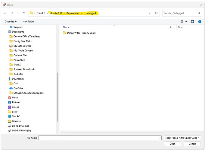

I’m having an issue when I add a new cover to a song, the dialog to locate the image file does not start in the “Cover art directory” as I believe it used to do.
Please check the options what you have set for the coverart directory:
Currently it is set to “C:\__Album Covers [Master]\” however when I right click and “add cover”, it starts in “H:\Downloader\__Untagged”. This directory is the location defined as “Favorite directory” however if I changed my “Favorite directory” to my album diretory, it still opens in “H:\Downloader\__Untagged” (probably using current directory).
