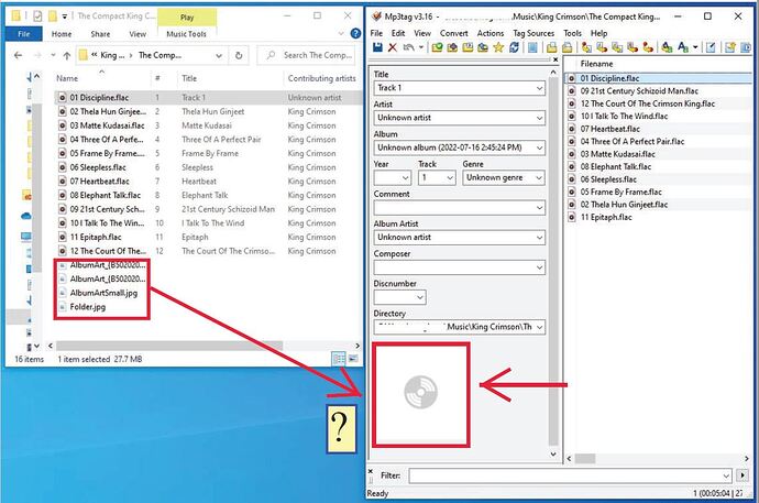

I'm ripping FLAC files from CD's using Windows Media Player. The album cover images (jpg) are being automatically created/sourced & are placed in the appropriate Artist sub-folder within the Music folder within Windows 10.
The images appear in Windows Media Player, File Explorer etc..., but do not appear in the MP3TAG image panel for info or deletion.
I will be mass deleting all of the cover art jpg files using File Explorer regardless, but I'm curious as to why no image files appear in the image box in MP3TAG.

  1. Is MP3TAG only supposed to show an image that is contained within the metadata or should it show the jpg image that is created during the ripping process as well ?
  2. If the answer to the above is yes to metadata images but no to jpg images, does the absence of any image suggest that there is no image information contained within the metadata ?
    I have reviewed the various tag settings & display settings related to cover art. Everything seems correct. Thanks in advance for your assistance. I hope that my screen capture image below is visible to you. It only appears as text on my screen.
See the setting in Tools>Option>Tags "Don't show files in the file system as cover".
MP3tag will, BTW, only help to delete embedded covers but not picture files in the folders.
(Unless you have added the extension for pictures to the included files - but this would lead to show the files in the file list where you can delete them).

You solved the issue I was experiencing. I have to admit that I did not look there. I looked under the Tag Panel setting & 'Display Cover Art' was checked. I didn't dig any deeper as I thought that would cover all instances. Thanks very much for your help.
