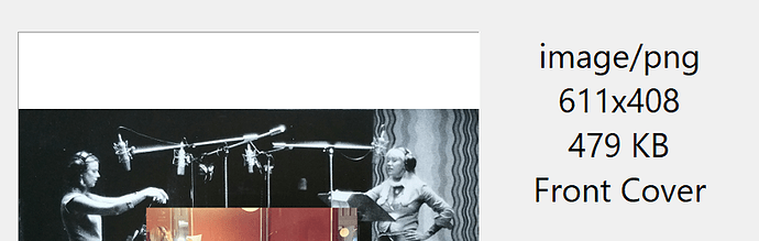

Hi. I am having the same problem but so far only with one album. I have disabled ABE, removed, resized cover image, tried another jpeg, png. Nothing seems to work.

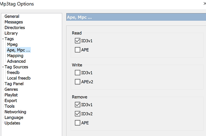

What kind of files do you try to modify?
Which tag versions do you read and write?
OK, thank you for the dumps.

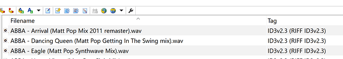

As you apply the covers to WAV files and it looks like the tag panel shows that you actually have embedded the cover - how do you know that the covers are not saved? If you get this impression from your player ... then it probably does not support tags in wav files.
