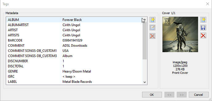

I've been using MP3tag to tag two custom fields that I use in my MediaMonkey Database. These are 'format' and 'country'.
It looks like this:
Now, this works fine and is awesome. However this only works with MP3 files and not with FLAC files. I can tag those fields in MP3tag but they won't show up filled appropriately in MediaMonkey afterwards.
Can I fix this?
The easiest way would be to add data to such a custom field in a flac file with your player and then use the MP3tag extended tags to see where the data ended up.
That was great advice. I found out where the data ends up and used the mapping option in mp3tag to make sure it goes there when I tag new files.
