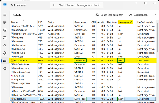

You can check via Windows Task Manager on the Details tab if both processes explorer.exe (if this is from where you're dragging the image file) and Mp3tag.exe are running under the same user (see the respective column).
In addition to that, enable the Elevated (in German: Heraufgestuft) column via right click on the column header and check if both the program you're dragging from and Mp3tag have the same elevation state.
In case it differs, you'd need to change it, e.g., by restarting the elevated process in non-elevated state for drag and drop to be working.
Just to illustrate this with a screenshot
(example from Windows 11 Task Manager)
