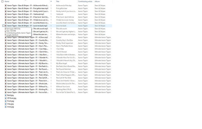

I have duplicates of every single song ie 2 #1's etc. I have spent a day trying to find a program to renumber in straight order from 1-40, but no luck. I joined here & don't want to write a program or scripts. I played with the autonumbering option which should fix it but nope.

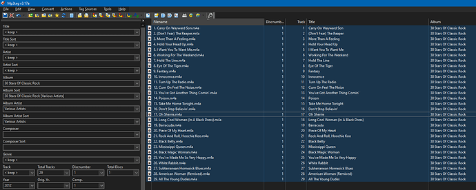

Grab a screen shot from mp3tag with at least these columns showing, a few more if they apply; filename, title, track, album
Something like this;

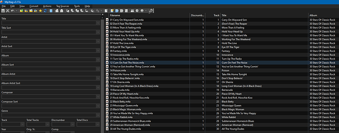

Using the exact same 7 steps I posted above, this is what the results were with this selection;
Note I intentionally deleted track 24 from this folder before I did anything. The first screenshot jumps from track 23 to track 25. So when I ran the numbering wizard it updated the list to run 1-29 in order. Then when I did the Action step to format _FILENAME it now lists them 1-29 and added the period after the number. So this works 100% to what you were looking to do.

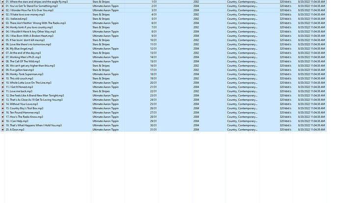

I decided to let your reply simmer overnight to see if it was clearer today. It's not. #1 Congrats on your taste in music. Being 71, I am really old school. It's called Classic Rock for a reason - lol. Anyway the problems I see with your list is it never had two #1 tracks etc to begin with. I also didn't notice the view screenshot ie on the left you got a box with all the options - choices. I played around with MP3 Tag & never could find that screen or option. I could get close to this, but not like yours. What I mean is way down at the bottom left your shot has a lot more options ( Track, Total Tracks). I doubt even if I could pull this up on mine it will fix my issue. So sorry - I may give up. But here goes.
1-Could the issue be that on my folder it has a bunch of different Albums under Albums?
2- If you notice on mine because of this issue it only goes to 20 tracks when if correct it would go to 31 tracks.
I also tried to do a screenshot of what I see with my MP3Tag with this album loaded.

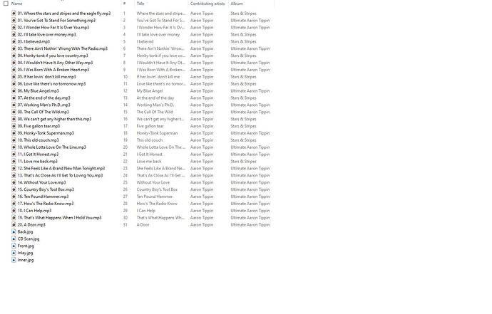

Maybe I am just dumb or maybe I should just give up. After reading your reply, I looked again ( really close). The issue that I 1st brought up is under the Filename Column is the issue. There it duplicates every track ie two #1 etc. Under Track column it's correct ( 1-31)
. Now in iTunes everything looks fine & it doesn't even show the track numbers. It only shows the 2 #1 2 #2'S etc in Windows Explorer. Being a bit OCD I was trying to deep clean my MP3 folders. I tried Music Picard, Tag programs, renaming programs nothing did it. Lastly I came across this option under Quick Options Replace with Regular Expression. You can see I got the 1st column ( Filename) but the next 1 or 2 have no clue what to input. Under Filename it gave me the choices - under Regular Expression it's blank so no clue what to input.

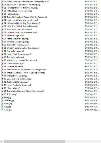

Still playing around & so sorry to Motely & Oh. #1 did fix the track numbers ( ie 1-31) so yay! #2 didn't do anything I tried looking for the converter & clicked on @ohrenkin but couldn't find converter. So sorry for the pain & work you guys have done, but I am pretty stubborn so will keep playing with it. To me the problem is the Filename. If I could strip the double numbers or ALL numbers out of the filename that would fix it. Here is the newest try with the correct # of track ( 1-31) but still the double filename numbers.
