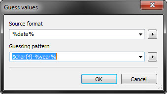

So all in all I just need to copy the contents of the date field to the right of the year and have the Year: in the format YYYY-MM-DD as this is what trakor Pro (DJ software) uses to read the release date all the while keeping the Date: field intact.
Please see my settings below probably very wrong :confused:
Thanks in advance
Yes the screenshot shows, that you have tried something worse.
What should the function $char(4) do in this context?
Did you ever looked into the manual or read through the FAQ section on this board?
Because of missing delimiter characters, there is no way to use the action "Guess values" in it's normal way. To solve your problem I would use an action "Format value" together with a function $regexp().
