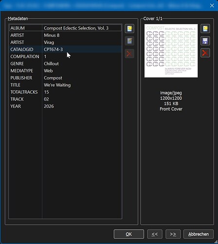

Please show us a screenshot from Alt + T with your ARTIST field content of the track with Minus & Virage.
The solution for your export script depends on whether we see two or more ARTIST fields or only one ARTIST field.
Thanks LL, there are 2 artist fields:

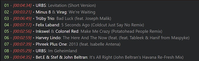

@LyricsLover I want it as you can see here in track 02 & 05, but not as in track 9:
@ohrenkino This does not change the result, it’s like in track 09 then.

@ohrenkino Check this:
Thank you.
With your modified export script, I get this output in your mentioned BBCode Text Editor:
Could you please provide the complete working export script to see your example output without the [artist] and [/artist] keywords?
BTW: There is no closing [/artist] after the last artist. Is this correct?
