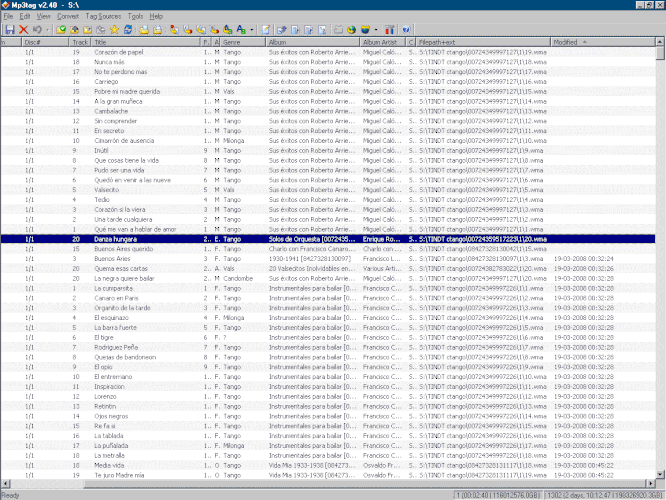

I undid a Remove operation, and all the affected files showed a blank Modified column, whereas the others showed dates fine. CTRL+T did not remedy this. Screen shot attached.
I then dragged the affected files into Mp3tag, and the dates showed fine.

Interesting, but I cannot verify this. Using version 2.40a with an external drive I did a move operation and the Modified value has been updated and then I did an Undo operation and the Modified value has been updated again. Seems to be ok at first sight.
But, huh, your attached image shows an interesting statusline.
D.20080319.0915.CET
1 (00:02:40 | 116012576.0GB) 1302 (2 days, 10:12:47 | 198326920.3GB)
Thanks for spotting that Detlev.
If I simply laucnh Mp3tag and load that same playlist again, and select that same file, I get a more sensible:
1 (00:02:40 | 11.1MB) 1302 (2 days, 10:12:47 | 12.4GB)
so there must have been somethng else in the procedure that causes the nonsense sizes - perhaps the Remove itself. I'll try some more after I've copied that file set for testing.
I've reproduced both issues and will fix them with the next version.
Thanks for reporting!
Fixed with Development Build v2.40b.
