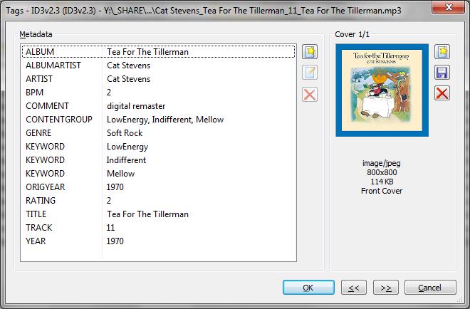

Yes, it can happen to a standard tag like YEAR. Below is an example of goofed up tags from other tagging software:
"Before" (good) ID3 frames & Mp3tag display :
"After" (bad) ID3 frames & tag display:
There's a TYER, TDRC, and TXXX, all with the year 1970 in them. And one can see the difficulty in the Mp3tag display telling what is what without seeing the frame associations, and required a separate utility to see which tags went with which frame (there's both a BAND tag and ARTIST tag, and YEAR displays twice). Yes it's not common, and what happened above is not Mp3tag's fault, but it is a very useful tool that if it could go a step further to show the frames it would be an even better tool and not require a separate utility to see that information.
