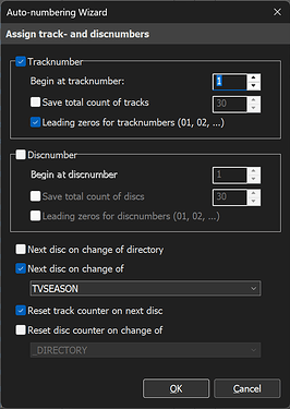

After trying a few things, this is the flow that worked best for me:
  • Set TVSEASON manually
  • Use the Auto-Numbering Wizard with the setup shown in the image below
  • Copying TRACKNUMBER → TVEPISODE using Tag to Tag
  • Clearing TRACKNUMBER field afterward
This does work, but it adds a few extra steps. Having native auto-numbering for at least TVEPISODE would make this a lot cleaner.
That said, I’m unblocked now and have a working workflow for batch renaming TV series files.
Thanks for the help.
