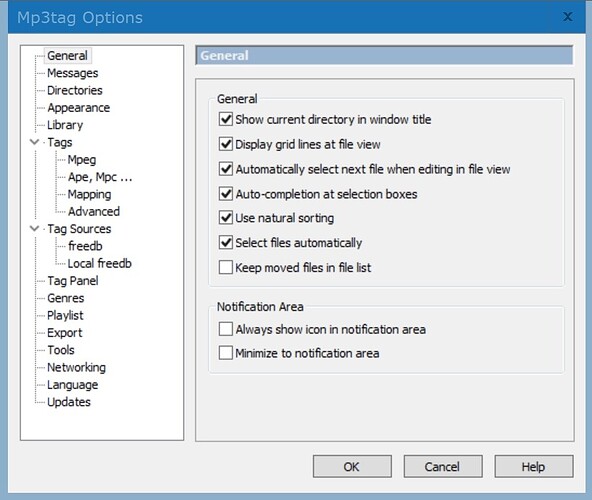

I'm on a MS Surface Laptop, Win10Pro. I have version 3.14 from March, 2022 and there is no such option (see screencap below). I did not do a full system-wide install but chose the Portable setup (because I also use mp3tag on my Kubuntu 20.04 desktop under Wine which works very well if one does a Portable install on a Window box, then copies the files over -- just runs and works for the most part).

The option I meant (thank you for the screendump) is the second from tht top:
"Display grid lines at file view".
It's a 3-state-switch which gives you 3 kinds of appearences.

I had no idea that was a 3-way toggle. I have looked at it and I will use the option that shows a small square in the settings box. That removes the alternate row coloring, but the grid lines are good enough. Now when focus shifts, the selected lines are gray, but only the selected lines are gray, which works for me.
