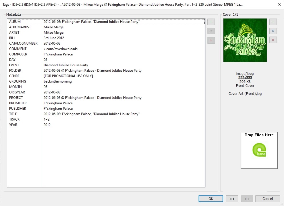

While preparing an archive recording for possible public release, I intentionally edited various metadata fields to use the censored form "F*ckingham Palace" for public-facing consistency.
During later verification, I noticed that different applications appeared to display different values.
This was not important because of the specific word involved.
It was important because it made me realise that I was asking a different question:
Not:
"What is the title?"
but:
"Which metadata frame supplied this title?"
and:
"Which metadata container supplied this value?"
After investigating the file, I found myself repeatedly wanting to see four things together:
Display Name
MP3Tag Variable
Actual Frame Name
Container Type
For example:
Title | %title% | TIT2 | ID3v2.3
rather than simply:
Title
Likewise, if multiple metadata containers exist within a file, an optional advanced view could potentially show:
ID3v2/TIT2 = value
ID3v1/TITLE = value
APEv2/TITLE = value
This would not change any existing behaviour.
It would simply expose information that MP3Tag already understands internally.
For everyday tagging, the current interface is ideal.
For archival work, preservation projects, metadata migration, troubleshooting, and auditing large collections, understanding the provenance of a value can be just as important as the value itself.
I am therefore wondering whether an optional advanced mode showing:
• MP3Tag variable
• Actual frame name
• Container type
• Value
might be useful for users working with complex collections.

Thank you for the reply.
I think this may be where my concern differs slightly from the implementation questions being discussed.
The reason I raised the suggestion is that I encountered a situation where I deliberately changed metadata, saved the file, and MP3Tag was configured to write all supported tag formats.
At that point I believed the metadata had been updated.
Later I encountered different information elsewhere.
What troubled me was not simply that another tool could inspect the file differently.
What troubled me was that I did not know how to verify within MP3Tag itself what had actually been updated and what had not.
That is the gap I am trying to describe.
I completely understand that other tools may already expose lower-level metadata structures.
However, from my perspective, needing to leave MP3Tag in order to verify the result of an edit performed in MP3Tag feels like an incomplete workflow.
The reason I continue to pursue this idea is not because I want to replace the existing interface, nor because I want to turn MP3Tag into a different application.
Quite the opposite.
I like MP3Tag enough that I want to rely on it more heavily, recommend it to other people, and build workflows around it.
My concern is that when I save a file, I would ideally like a way to verify within the same application exactly what metadata now exists and where it exists.
The moment I find myself needing a second application to answer that question, I start to lose confidence in my ability to explain the workflow to somebody else.
That is really the motivation behind the suggestion.
The issue for me is not whether metadata provenance can be inspected somewhere.
The issue is whether it can be inspected within MP3Tag itself.
Thanks again. :slight_smile:

Screenshots of the corresponding settings, example files (before and after) would illustrate the problem.
Whereas MediaInfo reveals this on the same file:
2012-06-03 - Mikee Merge @ Fckingham Palace - Diamond Jubilee House Party, Part 1+2_320_Joint Stereo_MPEG 1 Layer III_168611477.mp3
Format                                   : MPEG Audio
File size                                : 161 MiB
Duration                                 : 1 h 10 min
Overall bit rate mode                    : Constant
Overall bit rate                         : 320 kb/s
Title                                    : Fuckingham Palace (Diamond Jubilee House Party 2012-06-03)
Album                                    : 2012-06-03: F*ckingham Palace, "Diamond Jubilee House Party"
Album/Performer                          : Mikee Merge
Track name/Position                      : 1+2
Composer                                 : F*ckingham Palace
Publisher                                : F*ckingham Palace
Genre                                    : [FOR PROMOTIONAL USE ONLY]
Original/Released date                   : 2012-06-03
Recorded date                            : 2012
Writing library                          : LAME3.98r
Cover                                    : Yes
Cover description                        : Cover Art (Front).jpg
Cover type                               : Cover
Cover MIME                               : image/jpeg
Comment                                  : x.com/ravedownloads
DAY                                      : 03
MONTH                                    : 06
FOLDER                                   : 2012-06-03 @ F*ckingham Palace - Diamond Jubilee House Party
PROJECT                                  : 2012-06-03 @ F*ckingham Palace - Diamond Jubilee House Party
CATALOGNUMBER                            : 2012-06-03
BILL                                     : 3rd June 2012
EVENT                                    : Diamond Jubilee House Party
PROMOTER                                 : F*ckingham Palace
ORIGYEAR                                 : 2012-06-03
COVER ART (FRONT)                        : Cover Art (Front).jpg
Audio
Format                                   : MPEG Audio
Format version                           : Version 1
Format profile                           : Layer 3
Format settings                          : Joint stereo / MS Stereo
Bit rate mode                            : Constant
Bit rate                                 : 320 kb/s
Channel(s)                               : 2 channels
Sampling rate                            : 44.1 kHz
Frame rate                               : 38.281 FPS (1152 SPF)
Compression mode                         : Lossy
Stream size                              : 160 MiB (100%)
Encoding settings                        : -m j -V 4 -q 2 -lowpass 20.5
Type                                     : Cover
Title                                    : Cover Art (Front).jpg
Format                                   : JPEG
Muxing mode                              : ID3v2 APIC
Width                                    : 555 pixels
Height                                   : 555 pixels
Color space                              : YUV
Chroma subsampling                       : 4:2:0
Bit depth                                : 8 bits
Stream size                              : 296 KiB (0%)
