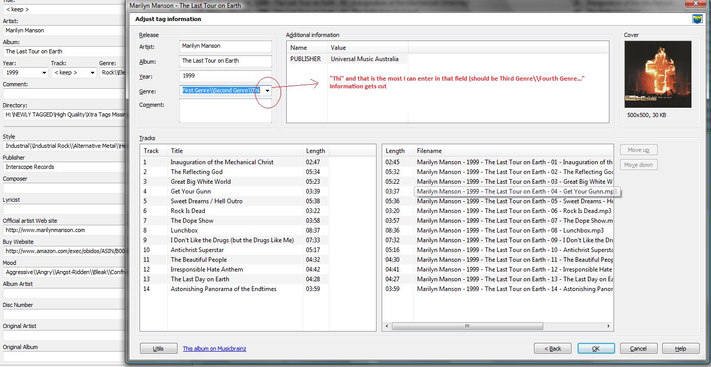

I noticed something rather strange last night. While tagging "Chocolate Starfish and the Hot Dog Flavored Water" from Limp Bizkit, when I did the musicbrainz import, the dialog automatically cut the album's name to a given length "Chocolate Starfish and the" (I think that is the length), but in the main editor I obviously was able to put the real name with all required characters.
Is there something I'm missing?
Same thing happens for, lets say, Genre. When I use the import dialog to lets say, put "Thrash Metal\\Groove Metal\\Symphonic Black Metal" or something like that, It won't let me, as it cuts the string. In the main editor I'm obviously able to put the whole string.
But I think this limitation hinders the usefulness of the import dialog for entering some information prior to doing "extra" tag edition not given by the auto-import feature.

The main editor is the regular window.. the one that cuts the Genre (but NOt the album name apparently) is the import dialog.
I do not understand what you mean with "import dialog".

But that is not the issue.
The issue is this, as shown in the picture attached.
