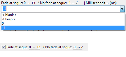

I have a suggestion: it would be great, @Florian, if we could use an "Edit Field" within a "Panel" tag, and define its "type" in such a way that we could program the two possible states of a checkbox (checked or unchecked). This would provide the flexibility needed to adapt this feature to our various programs...

As you can see in my image above, this option is faster and more visual than using a filter or an "Action"—the latter, incidentally, doesn't seem very well-suited to my needs...
Personally, I would prefer to have this control directly in the Tag Panel, in the form of a simple checkbox. I wouldn't imagine it being too complex for Florian to implement a feature that allows for defining a specific value associated with that checkbox—something that could be configured (i.e., what it should represent when checked or unchecked).
