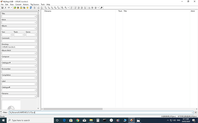

%_filename% MATCHES (?-i)^[a-z]
Does not seem filter out any filenames with a lowercase first letter of a word in the filename column even if I deliberately create some lowercase first letters.

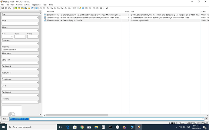

I know there are 3 song titles and file names that are medley type tracks with a)track title b)track title etc
eg a) Eleanor Rigby b) ELDS
"title MATCHES (?-i)^{a-z}" filters these and displays them but "%_filename% MATCHES (?-i)^[a-z]"
does not show them even though the filename has the same info basically as the title.
Also I was unsure what you meant by "(I am missing the %-parts of the variable names)"?
So is it that something like an "a)" or "b)" meant to display with the filename filter "%_filename% MATCHES (?-i)^[a-z]" ?
This is what I get with the 2 filters:
Please note the statusbar - this has been done on the same set of files.

  1. Using "title MATCHES (?-i)^[a-z]"
2.Using "%_filename% MATCHES (?-i)^[a-z]"

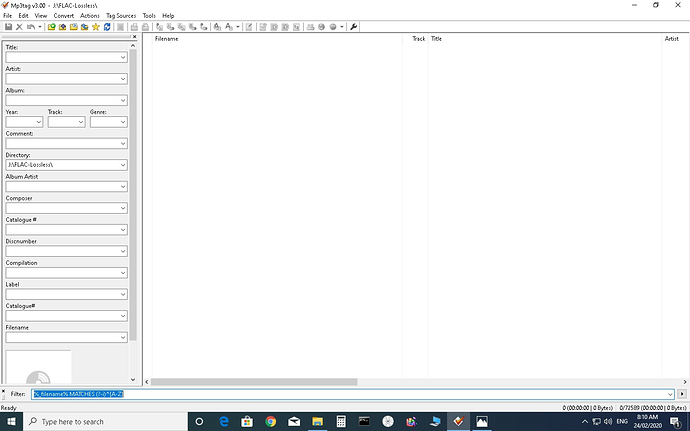

  1. Using "%_filename% MATCHES (?-i)^[A-Z]"
Thought that the a) or b) or c) (in the titles) should of displayed in the filename filter as in the title filter?
If I see that correctly, then the filename from a) is
05 Vanilla Fudge - a)....
So it starts with a number and no letter, regardless of the case.
So is what you are say that the %_filename% MATCHES (?-I)^[a-z] or the [A-Z] version will not really do the same job for filename as in the title search filter to filter out lowercase first letters....filenames for tracks usually have a track number so if thats the issue then the filter looks like it wont do what I wanted for filename.
Thanks.
What?
Your assumption that you filter for files with a lower case letter at the beginning will lead to no hits if these filenames start with a number.
It is no problem of MP3tag or the filter it is a problem of your assumption.
The string that comes from the field TITLE seems to be part of a larger construct:
Track, ARTIST, TITLE.
So cut away the first part and you should be able to compare the string.
The simpler way: find the files with a lower case at the beginning of TITLE and then rewrite the filename the way you want it.
If you got the case right for TITLE, then you can filter for files where there is a difference in the filename with
"$strstr(%_filename%,%title%)" IS 0
