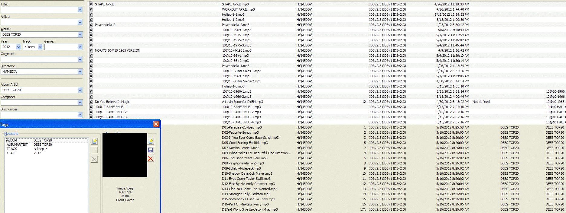

#7
Please see attached PHOTO. Am I missing something as it didn't work.
THANKS.
#8
The "extended tags" in your dump do not show the field TITLE. TITLE should be filled as well.

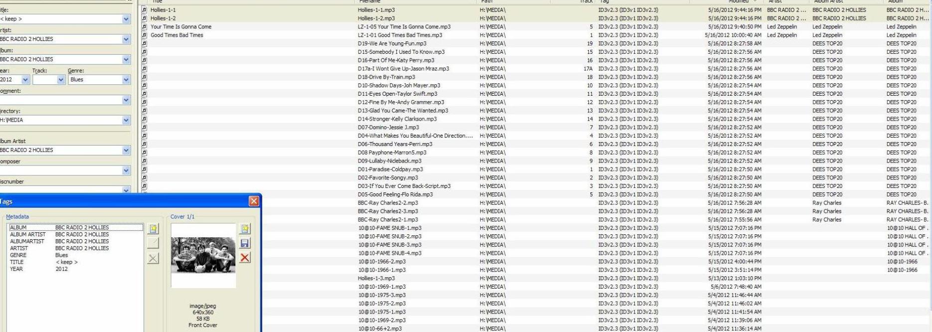

#15
First off: THANK YOU THANK YOU for ALL your attempts to help me solve this issue!
My work-around has been to create playlists. These are songs/programs I listen to and then delete (BBC Radio 2, a lot, as well as streaming).
To make it easy, here is a summary of where I'm at:
I tried using only ID3v1 tag and that was a mistake as, was stated, the art work doesn't show up, so I restored the defaults to recognize everything.
I noticed when I put a LED ZEPPLEIN album on the phone (see pic), it included all the variables and shows up as an ALBUM - perfectly.
I only seem to have this issue with ALBUMS I'm creating with MORE than four songs. All the ALBUMS I've created with four songs or less show up as ONE ALBUM, not an ALBUM for each song.
Thanks again.
P.S. I'm still waiting to hear again from LG!
And: I still don't understand WHY if I remove the TAGs, the albums don't disappear.

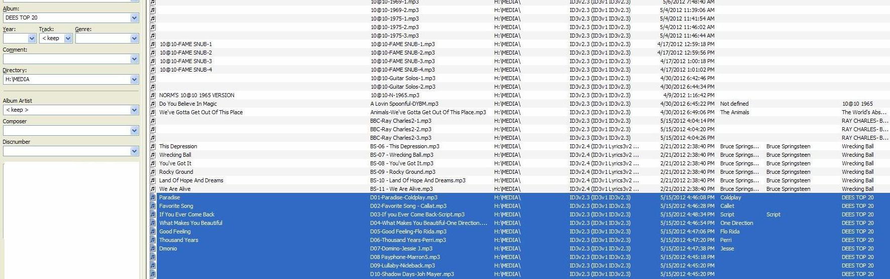

#18
Here is a screen shot with ID3V1 ONLY. That did not create an album and there is NO artwork.
This applies only to the three files I did this with.
This is a very weird situation as if you look at OTHER LISTINGS with v1 and v2 and APE (like the Zeppelin albums and the HOLLIES BBC entries), they worked perfectly showing up on ONE album with all the appropriate entries.
