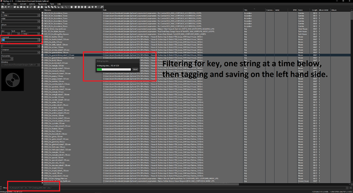

Here is an image of what I am doing to better illustrate. I put red boxes around the 3 things that I am doing for my current slow process.
