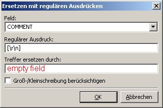

The RegEx module should understand \r and \n but it's also possible to use \d and \a
You can use (\r|\n) if you don't know exactly.

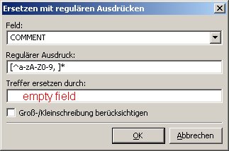

This should work:
And this too:
The bracketed charset should contain all the chars you would like to save.
