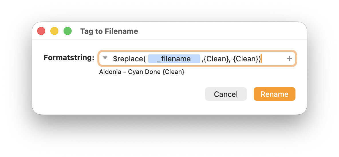

You can use Convert → Tag - Filename using Formatstring
$replace(%_filename%,{Clean}, {Clean})

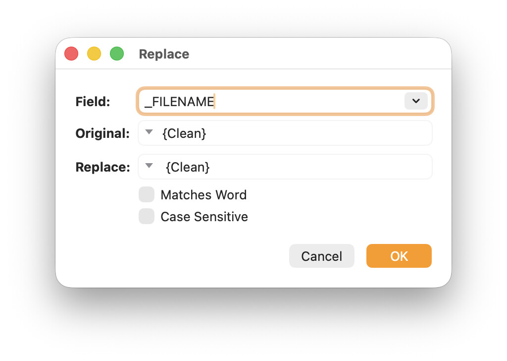

Alternatively, you can use a (Quick) Action Replace

this method worked much thanks much appreciated
it worked many thanks
