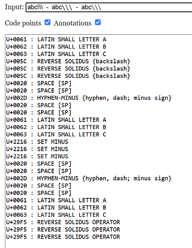

You could try it with Unicode characters looking similar like
U+2216 Set Minus
abc∖∖∖
or U+29F5 Reverse solidus operator
abc⧵⧵⧵

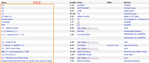

There seems to be a few TITLEs with 3 backslashes in the name:
Source: MusicBrainz.org
