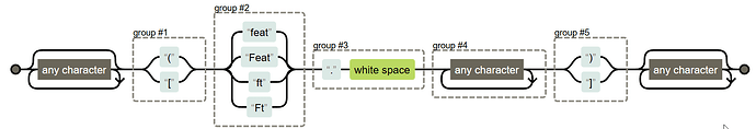

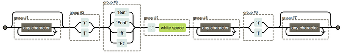

The two regular expressions now looks like this:
and
