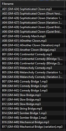

It's in the filename column. Here's the file list in mp3tag without zeros on tracks A1-A9 and B1-B9:

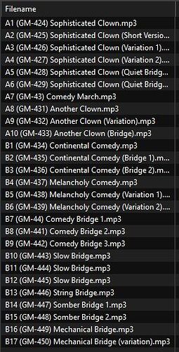

And here is the same list with those files with a zero between the starting letter and single digit number:
This is essentially what I want the finished list to look like.

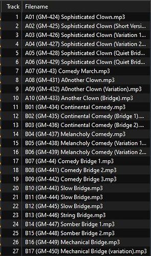

Here's the same list with the TRACK field included:
