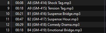

I have files that start with A1, A2, B1, B2, ect., followed by the name of the song. This makes up my filename tag, but it also makes it difficult to add anything in the middle of that $_filename tag. I would like to add non-tagged text in-between the two values and I can do that, but I have to do it in two steps. One for the A side and one for the B side.
I would like to know a way in Tag - Filename to batch add text in the middle of the filename while maintaining the filename values I already have. Here are before and after examples of what I'm talking about.

You could also use Convert>Filename-Filename
Mask over filename: %1 %2
Mask for new filename: %1 (GM-414) %2

The "GM" portion is a catalog number and the letters and numbers in the parentheses vary from album to album. I have a string code to insert what is needed based on the album. It was the text on other side of the catalog number that I needed split so it could go in-between them. This worked, so thank you.
