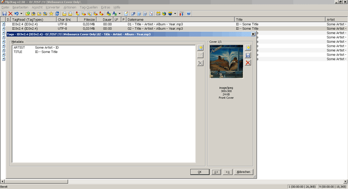

Doesn’t work. I’m running v2.50. lets see. I select one or more songs. I pull down “tag sources” > cover art > amazon.com. it finds “time passages” from album title. I hit next. It selects al stewart. I hit next. Then the cover art is displayed. I right click on the cover art for the option as you suggested and it really makes no difference. what really matters is there are two boxes at the bottom of the “adjust tag information” showing what it is going to replace. When the left box is empty then I can apply the art without clobbering my titles. When the left box contains title information then it will mess up my files. Sometimes I can get the left box to be empty but have not figured that one out yet. Think it has something to do with the data contained on amazon which is expecting the songs to be there which they are not or in a different order.
not IT but YOU should select the right entry. If the first one happens to be correct, then you are lucky.
In that dialogue box you do not have to click on anything else but the OK or Cancel button.
If you see the left box filled with data then you have not used
Web Sources >Covers >Amazon.com
but
Web sources>amazon.com
which is the dialogue for tag search (which also supplies the cover). In the latter dialogue you have to but the tracks into the correct order.
