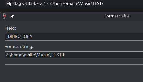

Linux: renaming/moving folders via _DIRECTORY doesn't work
Nothing happens when I run this action on Linux (the files remain in TEST).
However when I use _FILENAME instead of _DIRECTORY, Mp3tag has no problem moving the audio files to new folders (leaving behind lyrics, covers, log files etc.).
Is _DIRECTORY unsupported on Linux or is this a bug?
A similar action on Windows renames the folder to TEST1.

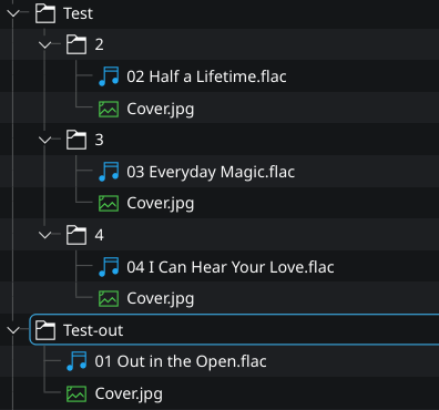

If 2 source folders get merged into one target folder and a file with the same name was present in both source folders, the first source file is overwritten by the second source file with no prompt, potentially leading to data loss when their content was not identical.
Reproduction steps:
2 songs in a subfolder each beside different cover files both named Cover.jpg
This action moves the contents of 1 and 2 into the same Test-out folder.
As a result, the Cover.jpg from folder 2 has overwritten Cover.jpg from folder 1.

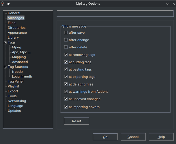

I have not changed them, but here are my Messages settings just in case:

From the results I'm seeing, the user's choice affects all files in the specific source folder and not only the file(s) with colliding names like on Windows where only the Cover.jpg files would be left behind.
Saying "no" to overwriting repeatedly (I've added 2 more subfolders to my test):
