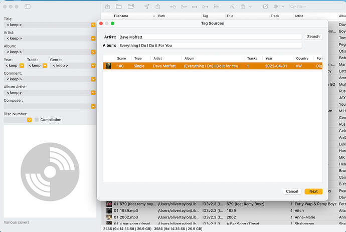

I have an issue where when I add in the library of files I am looking to tag, the pop up comes up to match tracks to the right source. When I press next, the app just freezes.
Can you send a screenshot of this popup when it’s in this unresponsive state?
As soon as I press next, it freezes and becomes unresponsive. I’m just trying to tag all these tracks with genres using MusicBrainz.

Are you loading Tag Sources with your whole library selected?
The feature works on a per-album level, so you usually use Tag Sources only with a couple of files that belong to a certain release (and not hundreds of files at once).

The tool only works on one album at a time. It would be unwise to run this blindly on a mass basis as you would have no way of confirming the accuracy of each of the matches found.
I realize you have a large library. Just work on it in chunks until you get it to where you want it to be. You will be much happier with the proper results in the end.
