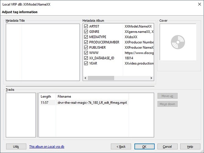

OK I have gotten quite far, if I may ask a question:
Is there any way to get rid of the "Metadata title" and "tracks" part of this dialog? As they are uneed when tagging videos.
Note the XXwhateverXX will be filled from the database, they are just placeholders.
Also can you point me in direction for linking a cover photo, I have them as url links in my dB just need to provide them to mp3tag
AFAIK there is no option to hide this GUI parts.
