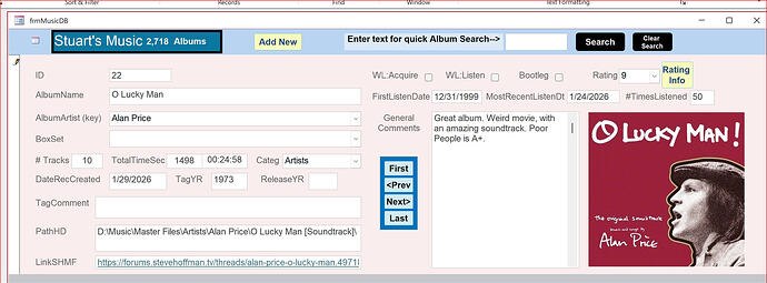

Hi @meomizzle interesting timing on your post. I’ve long wanted to be able to store more info about my music (approx 50,000 tracks). MP3Tag is an amazing tag editor, but it’s not designed (nor are tags in general) to store the type of info I want, nor to analyze your files.
So I decided to learn MS Access, and create my own database. I’ve been working on this about two months. I’ve learned how to export tags out, import data in, and create the basic tables I need. I’ve actually got a working database of my files, but it’s still in test mode until I work out all the bugs, and add more features. I hope to have the final working DB up by month end.

I can only answer for me…
I want to store info such as “First time listened”, “last time listened”, rating, listen comments, “don’t have but want”, “Bootleg y/n”, “Add this to my ‘want to listen’ queue”, and many more. This is info that makes no sense to store in tags. And I’ve researched dozens of music collecting programs, and none offer what I want. Most music programs are designed to track the music you own. My needs are very different.
I’m very active in a music forum, and it’s common to have a thread for each album release. I want to be able to store that URL, so I can go right to it.
Additionally, I have no interest in the tracks of the album (which almost every program is obsessed with). I only care about the album itself. I also have multiple versions of many albums (original, remastered, bonus editions, bootlegs, etc), each of which I want to track. Most programs fail miserably at that. The closest is the site Discogs, but Discogs doesn’t let you add much personal info.
I also have a lot of bootlegs, which aren’t handled well by any program. And a lot of Box Sets, where I need to track my info (as listed above) for each part of the BS, which no program does.
And finally, I don’t add that much music on an ongoing basis. Maybe 3-5 a month, plus the occasional box set release. It’s easy to add them when needed. The vast majority of what I listen to already exists, and is meticulously tagged, so the one-time export/import will work. And it’s rare to change an existing record.
Hence… my own database. I realize my case use is unique, which is why I tried every program I could find, then decided to write my own.
I really tried to find a way to make Tags work, as I love MP3Tag, and this new program will NOT lessen my need for it. But Tags just aren’t designed for this.
BTW, at this time, I only plan on three tables. It’s a simple, yet detailed, database.
Album Table
AlbumArtist Table
BoxSet Table
I’m also storing the path to the folder. I can use that to display the cover in my forms, without actually storing the cover image.
I also don’t care who the artists are on a song for my DB, since I’m not storing track info. Typically, I store that in the Tag, under Artist, for example “Taylor Swift feat. BoomDaddy”. But I do care about the AlbumArtist, Taylor Swift in this case. That field is being exported.

Lots of interesting ideas…
I’m not storing Track or Artist info, which removes all of the above except AlbumArtist>Albums. Which I do have in related tables. One to many.
“Don’t have but Want” is actually the same as any other record (database record, not album record), with the exception of a single Yes/No field that would be checked. Once I acquire it, I’ll uncheck it, and update any fields that might be off. I currently use an Excel spreadsheet to track my wants & wishes, this will enable me to eliminate that by integrating it into my DB.
My music player (Musicolet) stores no data for me, and that’s how I want it. I move music to it when I want to hear it, and delete it at some point. I update another Excel spreadsheet with date listened, rating, comments, etc. This will eliminate that spreadsheet also.

I’ve had this up and running for about a month now. Still making tweaks to it, but it works well for what I wanted.
